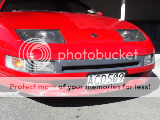

1 - The lower part of the front bumper, its also cracked but at least if I could get it sprayed or do something to it it would make it look miles better! Is it better to replace or spray? Can the bottom piece come off seperate or is it all part of the front bumper? In other words to replace would I need to get a whole front bumper or can I just get the splitter section?

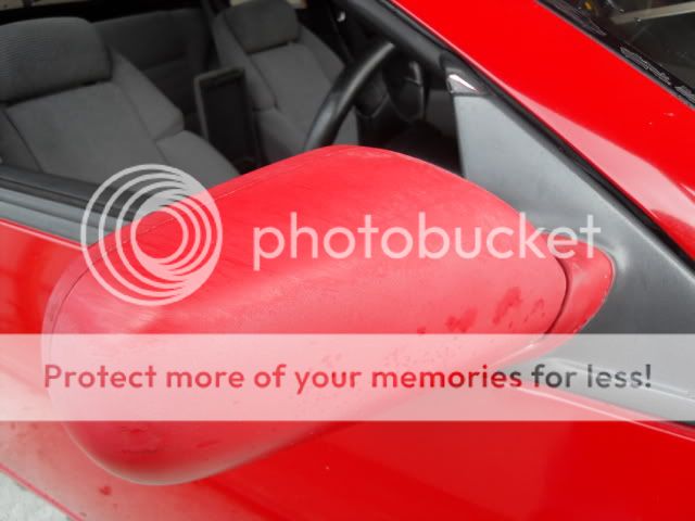

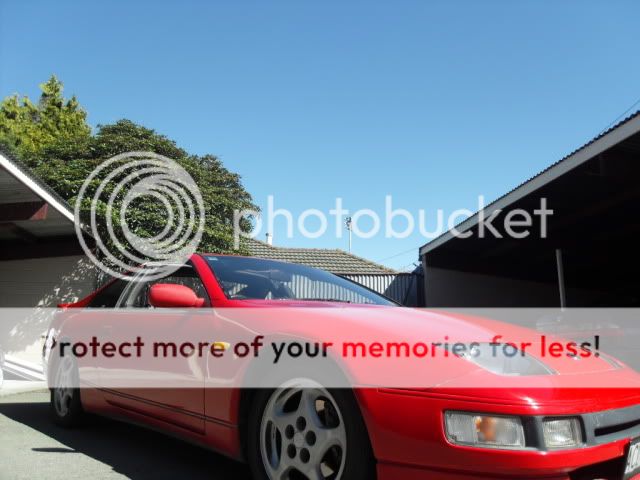

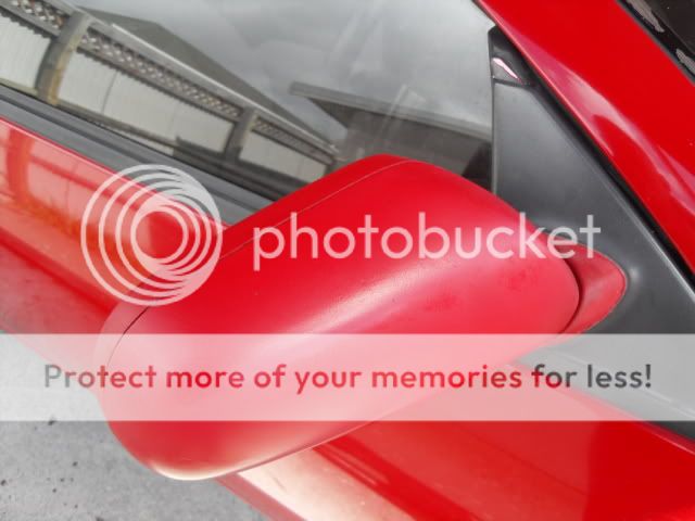

2 - The mirrors are faded, not a major issue but one I would like addressed. Any way of refurbing these or restoring the colour without a respray?

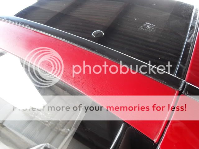

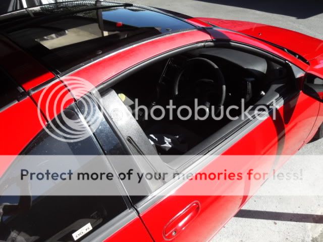

3 - The targas of course, again can the colour be brought back easily? You wouldnt think a small area like that would make a noticeable difference to the visual impact of the car but when the targas are off it looks so much better cause the faded area is removed.

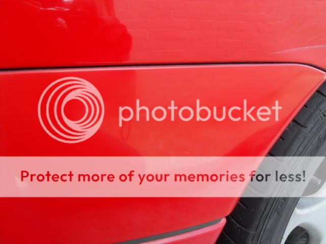

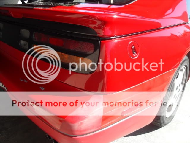

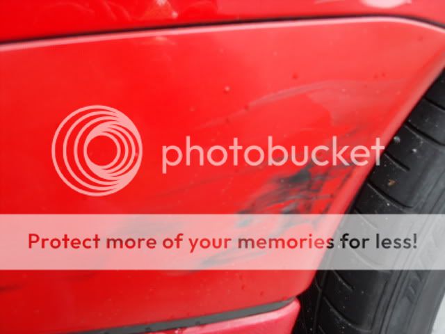

4 - The back bumper, bit more of an issue with this one, few deep scratches, and a scuff mark where it seems like a black plastic bumper off another car has rubbed it, thought it might T-Cut out but it didnt, its definately a surface mark only though so there must be some product to remove it.

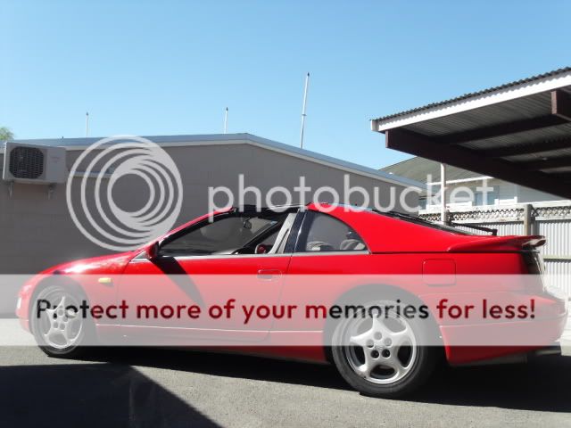

Oh and heres a pic that just came to me as I was going out a car park as the sun set, just one of those moments. :)
Personally I'd prioritize fixing that front bumper, that's what lets it down the most in my eyes. I don't think the bottom part of the bumper comes off, though I've never attempted to remove it so don't quote me on that.
For the Targa I'd say the only solution is paint. Unless someone has a better solution.
I've seen a friend of mine use a heat gun to bring faded black plastic parts on a golf back to life, perhaps the same would work for the red covers on the mirrors.

The bumper is a complete unit, it could be repaired, but would need removal to fix, which after the time and money spent, you could pick up a decent 2nd hand one.

I've worked with resin before so might try that on the front bumper to fix it up.

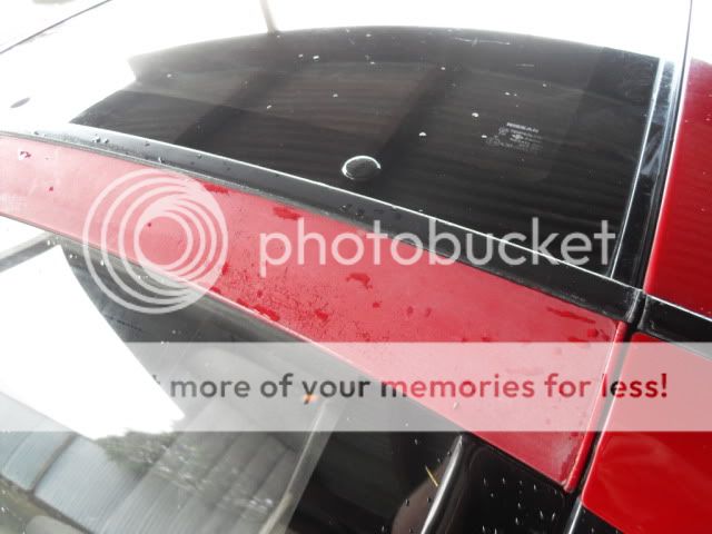

I decided today that the faded areas are so bad that I'd try cutting compound on them, if it doesnt work then I would end up spraying them anyway so might as well have a lash off the compound first. Tried it on the targas as a sample,
Before:
After:
Went to the mirrors then;
Before:
After:

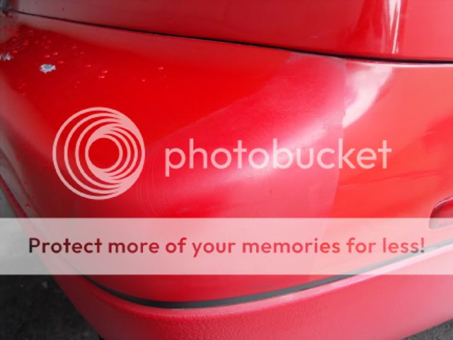

Next was the weird piece that was faded on the back bumper;
Before:
After:
And while I was at it I decided to try it on the scuff mark by the rear wheel;
Before:
After:
All in all I'm happy with the results, I know they're not 100% perfect but when you stand back its a lot less noticeable, I'm delighted the horrible scuff is gone off the back, and I think the back bumper looks a lot better too.

With fadded red paint, and looking at your pics they look crazed also, T-Cutting/Colour-Magic will NOT sort the problem, the only real solution is re-spraying the affected parts.
I had a red car in the past with a faded bonnet, once you used Colour-Magic it came up a treat, give it a few days and it started showing signs of fadeing again.
