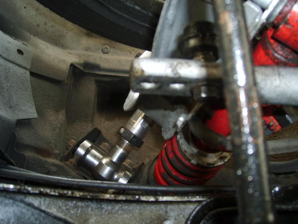

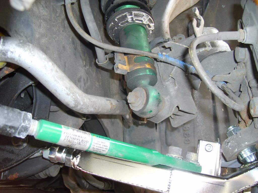

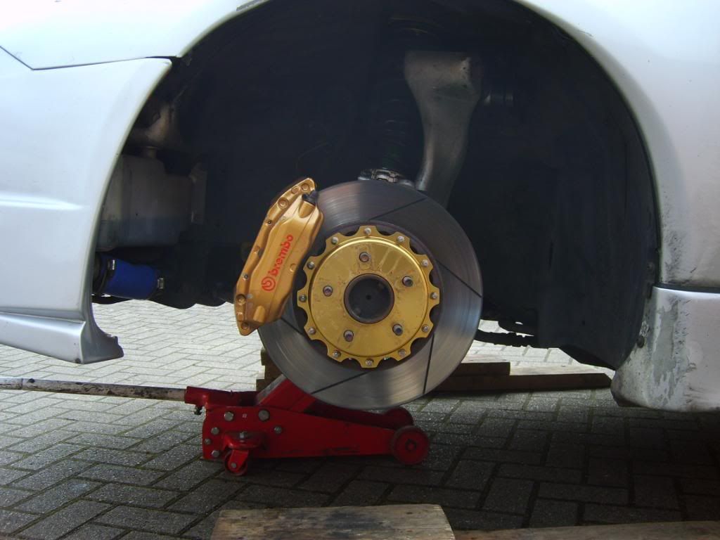

a few pics...
taken from below, looking up
taken from under the bumper, looking back
and... well, this one obvious ;)
what's the setup going on?

So i can see that the bottom arms are very similar to my 180sx Setup but i'm a little confused by the top 'arm'. Is there a ball joint on the top of the hub or is it at the top of that long cast silver thing i can see in the pic below?
Actually looking at the pic again is it some kind of spherical bearing between the hub and the cast arm?
The shock mount on the hub looks useful as i shall be using Short coilovers with an eyelet top and bottom.
How does the rack attach to the hub? is it infront or behind like my 180?
