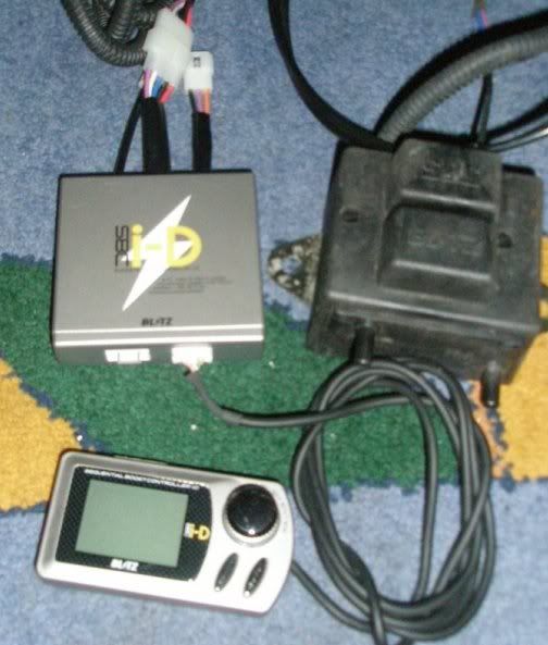

I've just acquired a Blitz SBC i-D II BC sans fitting instructions and wondered if there are any diagrams etc to assist with the installation?

It took me about 3 or 4 metres of hose to route from each pipe to boost solenoids and hard intake pipe too. Also needed 2 tees i think and 2 straight connectors to connect to the existing hoses then all the usual jubilee clips to go with it. it was 8mm tees i used and pipe to match just needed smaller hose for the single blitz solenoid as 8mm is a bit big for it. Ill have a look in the light tomorrow if you want and check mine

Cheers Marty, I'd appreciate that. On the link you provided above, it say 1.5 metres of hose, must depend on where you join on the hoses I guess?
had a look today ive used about 4m of hose 2 tee pieces and 2 straight connectors all 8mm. I have the single solenoid and have located it next to the brake master cylinder so you need 4m of hose to get it routed up to there makes it easy to get the cable through to the dash area though and ive put my unit in where the clock is just removed the clock and did a little widening and fits fine.
Thanks Gonzo - 4m = 13.12 Feet, is this what you meant to put as it seems a lot compared with the above install link figures?
oh thats the twin solenoid you wont need as many tee pieces then i think that link i sent will clear it up for you
mine is a different unit and i have single solenoid so had to do more routing on the hoses i think then you might be able to get away with 2m you will have to see
