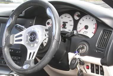

Thats definately a white dial kit, but i'm after something like the ones i had i my mr2 which were plainer and less colourful. like below
So thanks for the offer Zairs, that was really kind of you, but i'm going to have to decline.

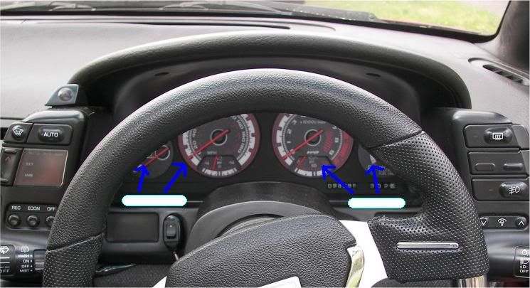

Graham,, erm no, i'm after EL Glow dials , the LEDs i was asking about are the ones you mentioned above, as i said, i assume you are talking about the bulbs that throw the light forward, see below or are you talking about LEDs behind the dials
Sorry bud the 501's are for behind the dash, they also light up the needles via the plastic diffuser around the dials.
The ones you have pictured you dont need at all and if by any chance yours work, then take them out.

Thanks mate, i can however see where you're coming from, in the pics of the dials the needle is not illuminated at all, i'll check tonight to see if that's the case. would those leds do the job or would they screw up the indiglo's
Rich
They will be fine, they do not shine through the indiglow as its too thick for the light to penetrate, but will light up the boost gauge and oil press guage as this is the only passage for the light to pass, but will look cool.

I had this with my White dials, what I did was to dismantle the Oil and Boost gauges and stick black tape to the clear parts that allow the light through! = No extra light on the dials to spoil the effect*
* = I say spoil because the light behind is RED, and I wouldn't be able to see anything if it was flooded with red light as well!!

Graham, your lights looked good with the gauge bathed in light, but if you didn't want that, good idea Dave.. so i think i'll put some led's in the dash like Groover and mod it like Daves_Zed suggested...
