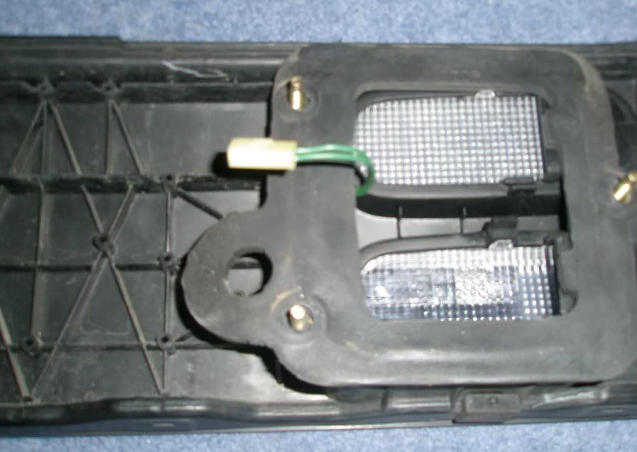

I bought this light panel and noticed it has an extra connector - would this be for the '300zx' logo on the back? If so, I'm assuming it will be led's fitted...is there a connector to hook this up from the factory, or is it something I'll have to add?

I have two panels here, the one with the wires has slightly raised lettering and a hint of red compared to the other panel with no wires.
If I photograph the panel, what am I needing to try and highlight?
I can't see how the wires are for a fog as they disappear behind the paneling.

Do you mean it needs an invertor stu? I've tried a 9v battery on both ways but nothing...

Hmm well maybe it doesn't light up lol maybe the leds are damaged, need to know really if they need an invertor or just run off 12v...:confused:
Looks like the connector for the illuminated 300ZX logo, you just need to plug the inverter in and connect it up and you should have it working.
That does look like the factory light up rear panel connector. It used a Electroluminescent strip, rather than LED's.
It is however missing its invertor, so you would need to get one for it to work, then it just needs a 12v positive and an earth feed to it.
price the invertor up at your local dealer, thats a gem of a find!
Yes 12v supply, connects straight into the cars loom behind the panelling in the boot

Yeah this is factory fitted, it's a paper thin light unit behind the 300zx letters i had one on mine. it should connect to a white inch square box bolted behind the light units. Mine doesn't work i'm presuming the box (resistance unit or something) is knackered as it buzzes quite loudly. If you get it working should look sweet.
