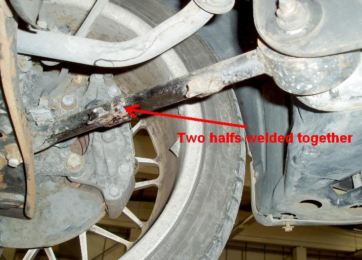

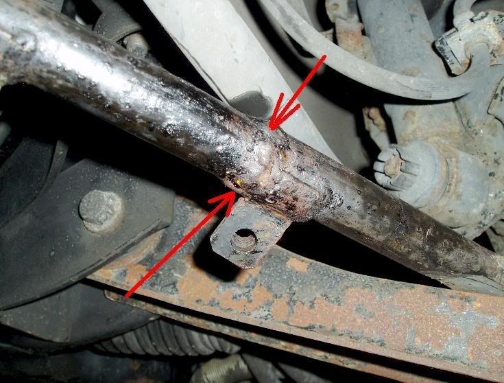

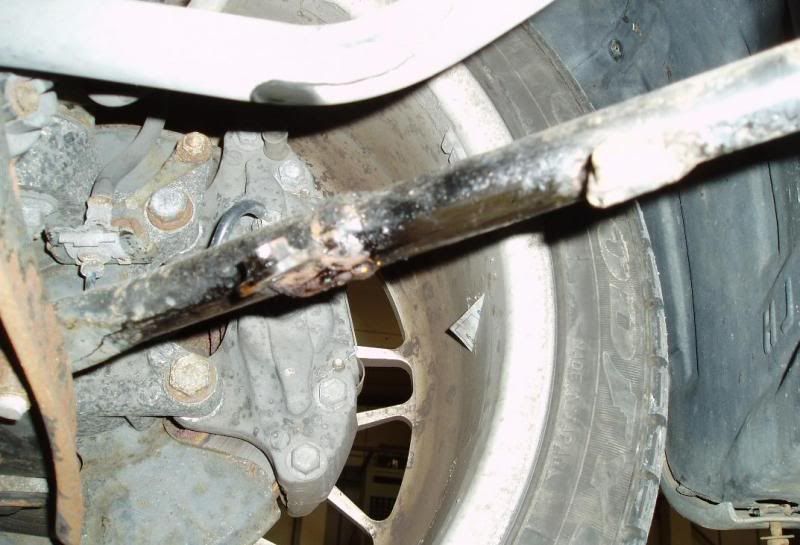

Seen a few things but this even surprised us last week, the near side tension rod arm is two half's welded together, who, what and why is a puzzle as the zed has a recent new owner, but worse still the two half's where slightly longer than a standard one so that side of the car had around 20mm set back on that wheel?? a good used replacement rod sorted it and the set back out, had to re-track it but after that all was good ..... odd :confused:

I've heard of credit crunch but thats just insane, wouldnt the car drive and steer really bad due to this?
i know when the front rad support bracket went on my old zed where the tension rods bolted into, it was nearly undriveable, would pull to one side under braking
We need to start a "101 ridiculous things people have done to a 300zx!!" thread
lol wouldnt have like to have it snap at speed my old ebay ones snapped going over a speed bump luckily wasnt going fast did enough damage to my side skirt as it was
