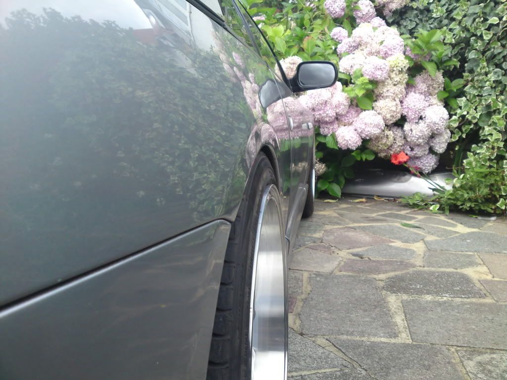

Those rears wont fit unless you undertake some serious arch mods and some -camber... or you could run a very stretched tyre but it wont look good unless its nicley tucked underneath. my rears are now 9.5 et20 and the wheel sticks out a touch but the tyre tucks in because its slightly stretched.
here look

Take a look at mine, they are on 9.5 all round with slighty stretched tyres. They stick out right to the edge they are on the limit, pretty sure i cant go any further unless i do somemore arch modding. Why dont you go for a 10.5 rear and a 9.5 front? that way youl have a nice fat rear wheel and the front will be pretty chunky too. it will be a hell of a lot of work to get the 10.5 on the fronts.
