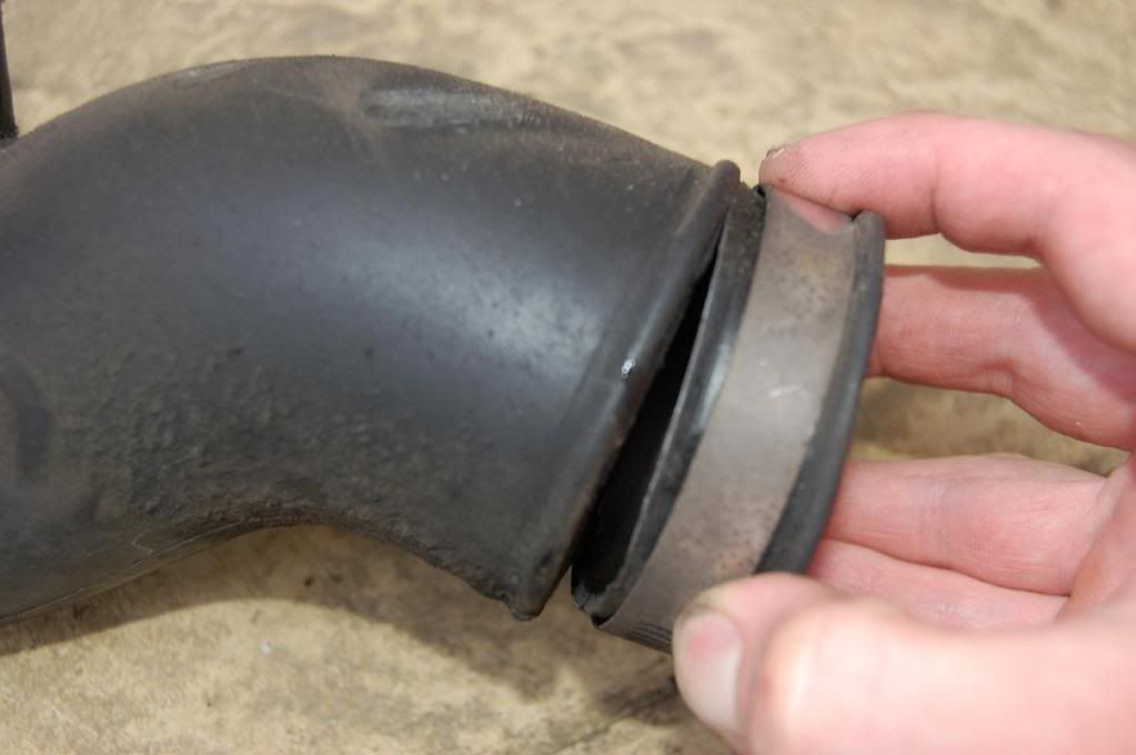

Some of you may know I bought the red UK TT in my sig with a seized turbo. After carrying out the latex glove test on the pipe it turned out to be the drivers side turbo which was not working, not the passenger side like the previous owner had been told. Yesterday afternoon I started stripping down my engine ready to replace the drivers side turbo, but upon removal of the large hose from the turbo to intercooler, I found this big split going half way round the hose (turbo end of the hose):

Could this split be enough to stop any boost? I guess it could be but just need confirmation. I have a spare hose, should I fit this and build it back up or continue with plan 'A' ?

that pipe looks like it is from the air filter/maf to the tub. is it the hard pipe?
if so it would not cause a boost leak but would run lean on boost
Your not gunna get any positive boost with a pipe looking like that.

Looks like the plastic supply pipe to the tub.It would not cause a boost leak but let unfiltered air into the turbo which would not do it any good.Probaly is goosed mate.
Thanks for the responses guys.. bit of a mixture of views! Do you think I should carry on taking the engine out? Is there any way you can physically get to see if the turbo is seized without taking it completely off?
Have to agree with jimmytt. If this is the pipe from the turbo to the intercooler, all your "compressed" air is going back to atmosphere. Any pressure you might make with the other turbo will be vented back through the balance pipe.
I think jimmer knows which pipe it is more than me, hes taken off a few in his time........
Would agree - if this is the compressor side to the IC then its your problem. All boost escapes here from both turbos. If you are already at the turbo end of the hose can you not get a feel for the turbine blades to see if they are freely turning? If so you might be on an easy repair. When they seize they tend to go solid. If its still spinning its probably OK.

If the pipe is plastic which it looks like then its a supply to the turbo.Any pressure pipes are metal joined by rubber.
Its a rubber pipe. Its the one with the flexi section in it on the drivers side.
balls. oh well thanks for the advice guys, is only about half hour from bring out anyway :dance:
