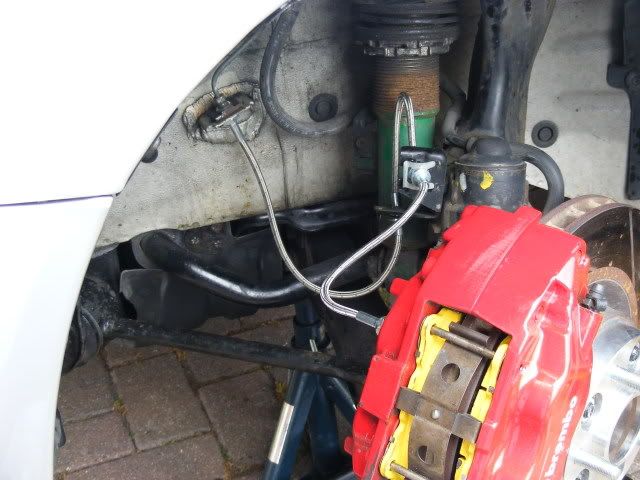

Well following on from KrsMayos thread on a different site
I thought I would have a go. Now keeping in mind i dont know anything about nothing (as the kids say) I am pretty pleased with myself.
Really thought I would struggle to get them under my 17's but I did it. You can see from pic 1 how tight it is behind them wheel.

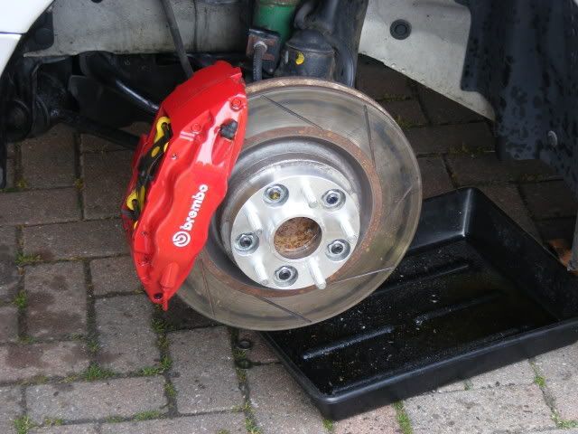

Placed in the rim to check there was a chance they would fit before i started, only just
350z 324mm discs, Brembo Evo 8 calipers, EBC yellow stuff pads and 25mm driftworks spacers to help with spoke clearance issues.
New braided hose fitted

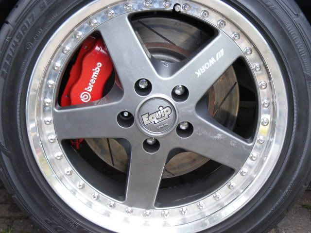

Wheel back on, sure fills those 17's
I love the wheels too, really glad I didn't sell them, I nearly sold them as I thought I wouldnt get the brakes behind.
