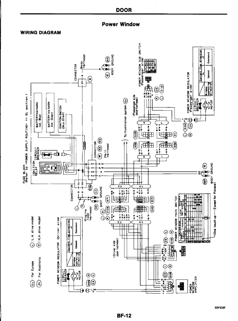

thanks eyes i had this problem a couple of years ago and soldered the dry joint and worked fine. this is both windows so im thinking they must be a fuse somewhere
:rofl:thanks andy i'll try study that. stevie wonder could probs read that better than me when it comes to wiring diagrams.:rofl:
Under the bonnet next to the brake master cylinder slim black box, green fuse second in from the engine marked up power seats and windows.
