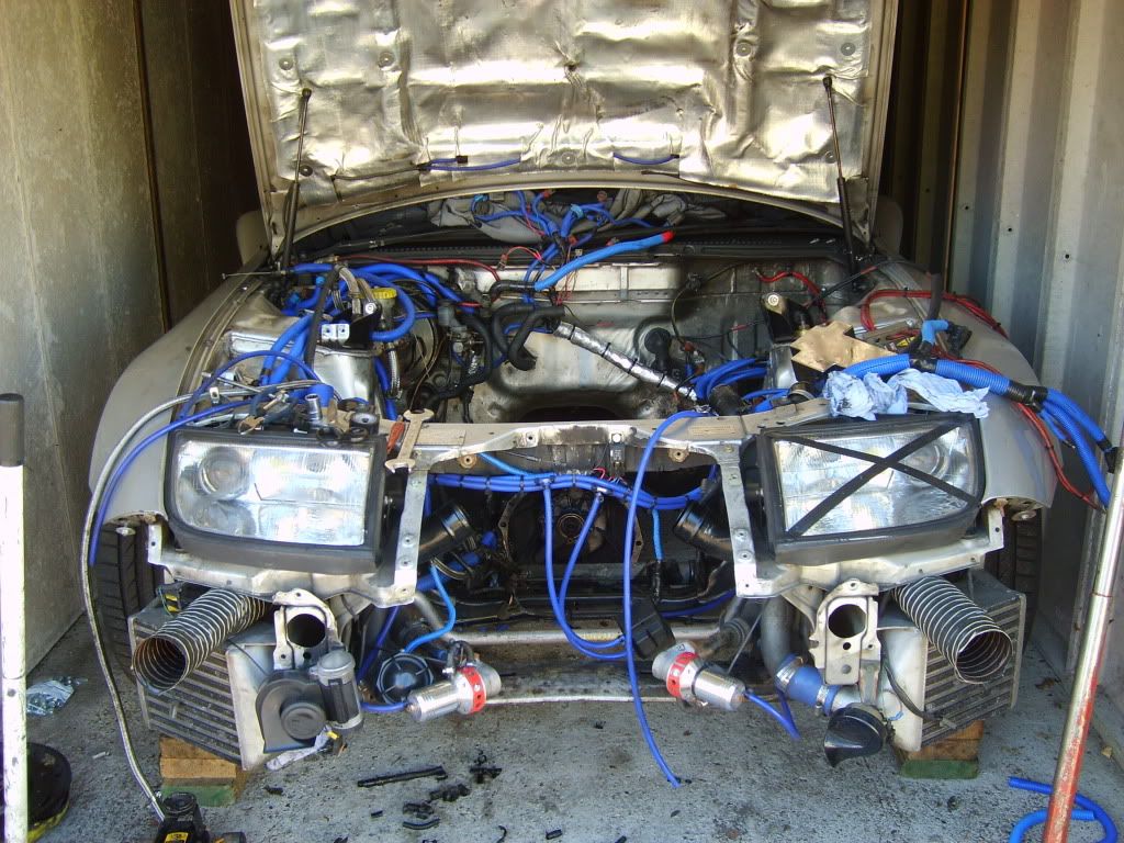

I´m just in the process of doing a carbon canister bypass , so front fender is off and I thought I´d take the opportunity to replace the fog lights with the carbon fibre air ducts I´ve had lying around for a few years:dance:. Two questions though:
1: For those that have done the air duct thing , which bonding agent do you recommend ?
2: Did you lead a tube/pipe from the ducts to the intercoolers, or just installed them as is ?
Cheers :)

I put my smic duct's in with silicone adhesive. Some mesh on the back and thats it!!
The lower opening feeds the lower part of the ic, and the venturi duct feeds the upper part of the ic.

I used sikoflex to bond them in. And i did'nt use any piping etc to direct the air - i just let all that lovely fresh air gush in and cool stuff :D :nana2:
i used good old sikoflex to hold them in with, and some 3" hose running over the intercoolers around the suspension then onto a plate bolted to the back of the hubs...

cheers for the advice guys ...got the sikoflex and I´m ready to go with the ducts.

make sure you fit them on straight though.......put the left one on at a slight angle but it´s stuck solid :headvswal, so....next time the front facia is off i´ll have to cut it out from the back and refit it again ..bummer
what stsrted out as an easy job..............
