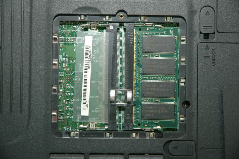

looks like I "might" be in luck as I found the following on the back...
Right...if I'm going to do this it looks like it's just going to be a RAM and HD upgrade.
have a look here for the maximum ram it will take.
Now that was helpful! :D Looks like it can take up to 2GB of Memory in total (er...not that I can afford 2Gb of memory at the moment! :( ). 1Gb is definately do-able though...cheers for that! :)
