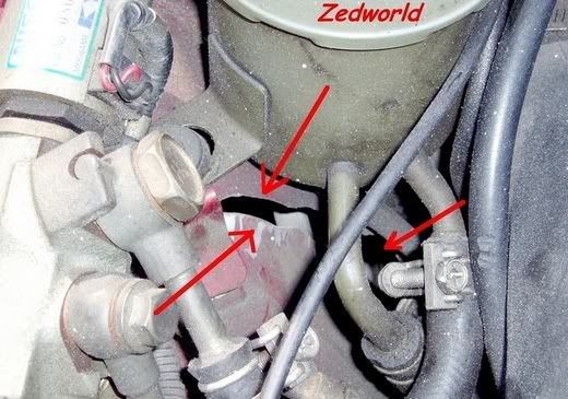

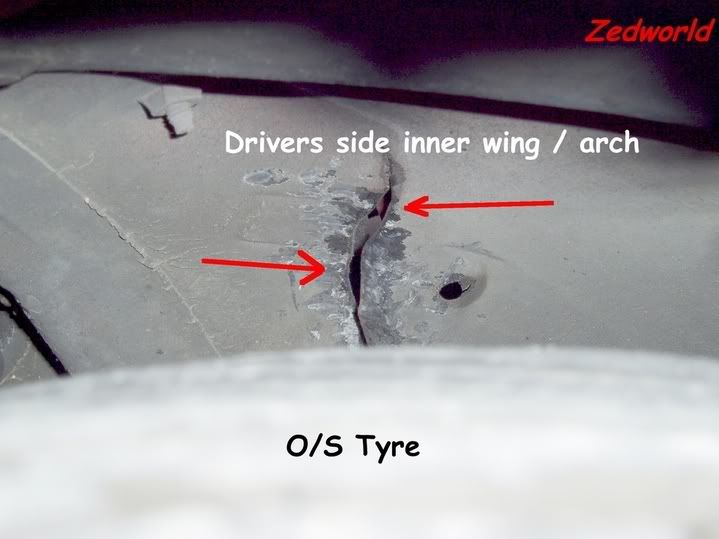

Badly repaired accident damage can spell trouble for subsequent owners of any car but below is a horror story in the making we were witness to.
The o/s inner wing section was split completely away from the car structure, all along the chassis rail and along the inner arch, the only thing keeping it in place were the strut fixings and the outer wing bolts.
The owner had the previously day been having fun at high speed and was aware of a “funny feeling” on the front end...............jeeez.
After inspection it was evident that a previous repair had gone very wrong, a new chassis rail/ leg had been fitted but the iner wing had not been welded back in ( at any point) and in use the constant flex and stress had caused metal fatigue as can be see with the splits.
