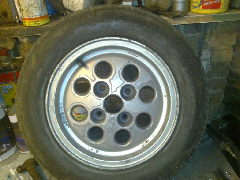

then needed a refurb anyway as the lacquer had started coming off and they looked awfull
so i rubed the wheel down

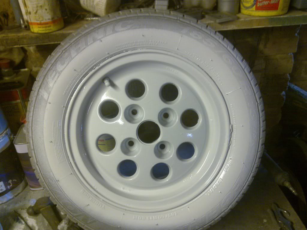

then cleaned the wheel ready for the primer
gave it 3 coats of primer and flatted it back with some 1200 wet and dry
cleaned the wheel again

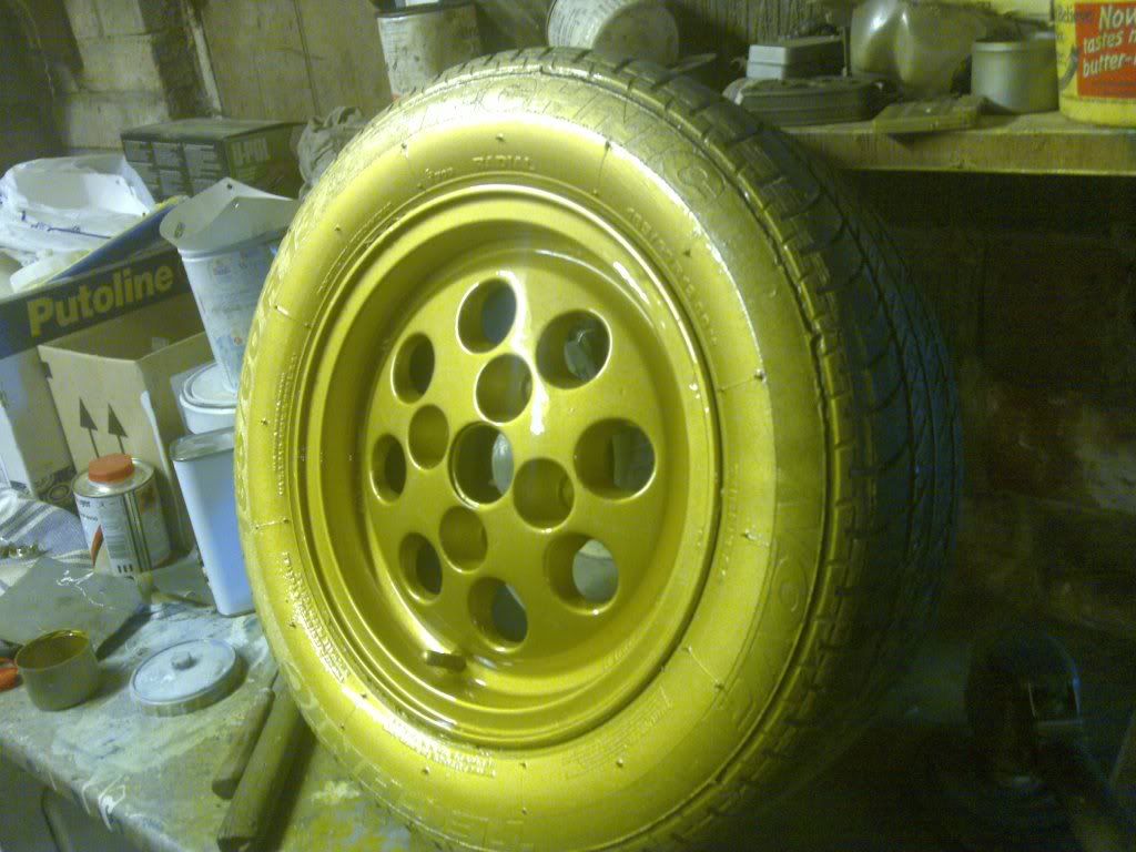

and then gave it the first coat of the gold
let it dry and a quick 1200 then 2 more coats of the gold
let it dry again
cleaned it yet again then i clear coated it 3 times
let it dry and cleaned the wheel for the final time in all it took me 5 hours todo lol but quite alot of that time was watching paint dry :p :p
im not worried about the tyre as its knackerd anyway i will have to mask the other 3 up if i like the colour on the car
well not my car but my mates car lol :rolleyes:
