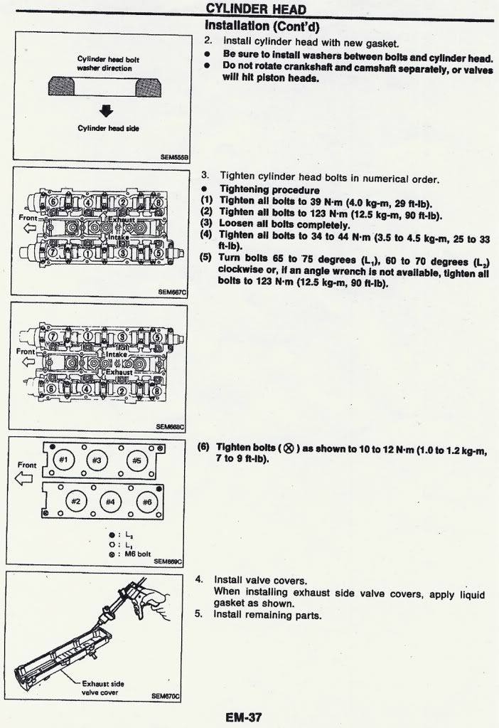

well im rebulding my engine so i need all of them but the main ones are the headbolts main barings big ends flywheel and any others you come across mate
the others i can find out at a later date thanx for your help :)

if you're rebuilding then i would sujest you use ARP bolts for the main and head.
all exploded diagrams in the owners manual will have torque setting on them.
main bolt 90-100Nm
head bolts...
tighten all bolts to 39Nm,
then tighten all bolts to 123 Nm,
then loosen all bolts,
then tighten all bolts to 44 Nm ,
then tighten all bolts to 123Nm
main bolt 90-100Nm
head bolts...
cheers mate that makes pefect sence and is what i was looking for do you happen to remember the order ??:smash::smash:
