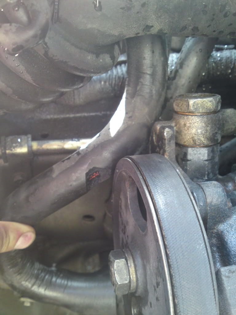

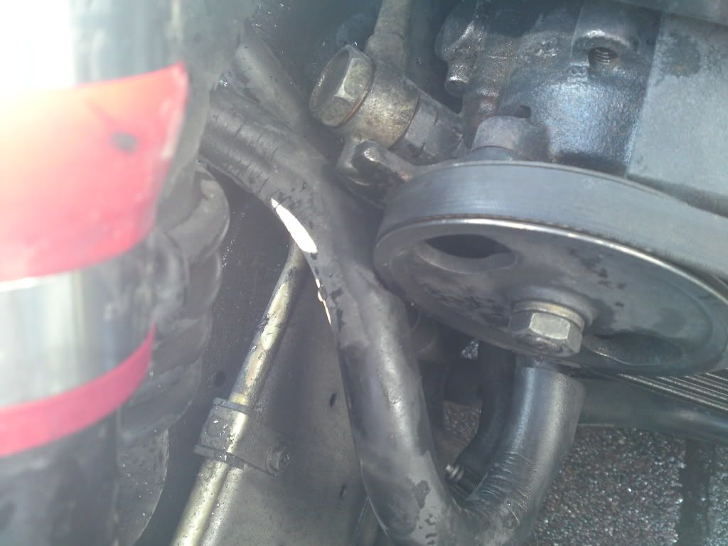

Today i fitted a new thermostat and while doing so i noticed this:
When i bypassed the hicas and relooped the pipe i must have moved it slightly towards the PS pump whoops, ive done a quick fix and cable tied it back. Close one hey :dance: Would of made a right ol mess down there.
Its only cut through the outer protecting foam and into the rubber slightly, not made it to the core thank god.
So i suppose anyone who has done they same just have a little check.

Good spot Jim, if not your nice new engine would have been covered in muck, plus its sticky muck too.
