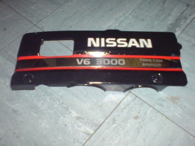

I rubbed it all down with emery cloth, plastic primed it.
Since i wanted the nissan to stay white, i masked over the writing and sprayed it the same colour as my car.
Did this a few times, rubbing down with 1200 grit after letting each coat dry.
Removed the masking tape from the letting revealing the white writing.
Gave the whole thing a few coats of laquer and put on a Smithy's polished strip thing!
Job Done

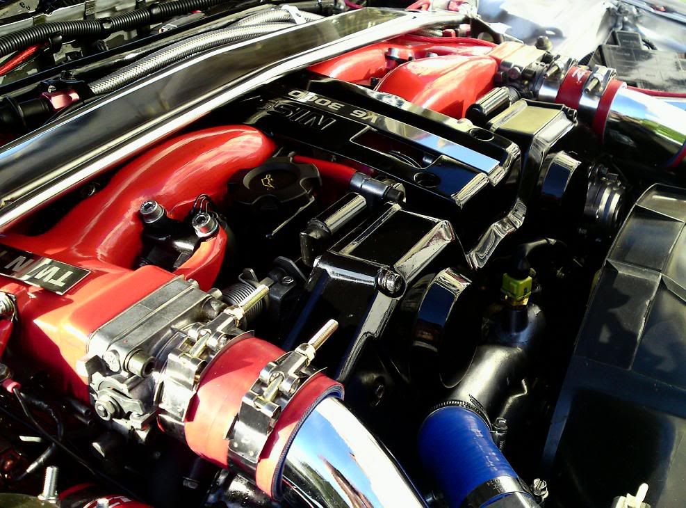

After a good polish ;)
That looks fantastic Jimmy. :cool:
A red water top hose would finish it of nicely.
I have to agree, Jimmy's engine bay looks great :bow:
I like his throttle cable cover sooooo much, that I'm going to attempt to duplicate it in my own cack-handed way :D
