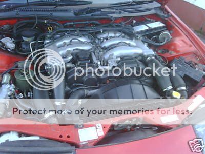

thats my engine can you see the coolers from there?
Your intercoolers are behind the bumper mate right where the slats should be.
