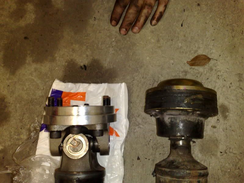

Ive got round to taking my old TT prop off today:hyper:
But when I got my new prop out it was about an inch and half shorter.
Im hoping I havent recieved a short wheelbase version as i bought it months ago.

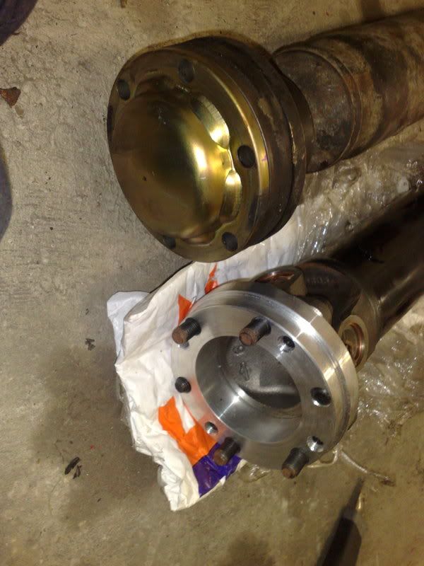

I have noticed that the end of my old prop is different as pic!
Do I need to take the end bit off and fit it to the new one or have I got apart missing.
Any help will be great and Happy new year!
Dan
Have you got a shot of the whole prop, each one side by side? I am not used to hese cars so cant comment, but that looks to be the wrong end??
theres nothing wrong there, thats as it should be. the ally spacer will bolt to the diff, then the yoke will bolt to the ally spacer. dont worry about the lengh difference. fit it up and i asure you it will fit as there is a certain amount of travel on the gearbox spline.

Do i need to take the brass end off the old 1 and fit it to my new 1? I have already tried but it wasnt the best of fit.
Ill try my best and get down to my workshop 2moz and get them measurments for you1
nope, the brass end stays with the old shaft. you will find that the ally spacer is a tight fit in the diff. its best to offer it as square as possible then nip each bolt up in turn keeping it square as you go. it should slide in nicely.

Yep, thats fine. The SWB version is a lot shorter, 6inches.

Yep mine was shorted too, the spline slides in and out of the gearbox.
