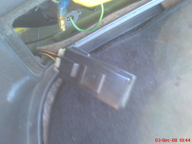

It will be the little black box behind the boot trim. Its on the Drivers side, you'll need to remove the plastic boot trim to get to it. Black box about 3" x 1.5" x 1", with a single connector.
Could also be a loose connector behind the fuse box in the driver side footwell - I had the same problem a few years back.

Hi Bud if you can show me a pcture of the box behind the rear lights you need i probably got it here........
Welcome to the site buddy and looks like a very nice car to :)
I cant find any pics, but its Black Plastic. Approx 3" x 1.5" x 1" with a big female connector at one end.
It lives behind the boot trim where the Boot interior light and electric aerial are.
