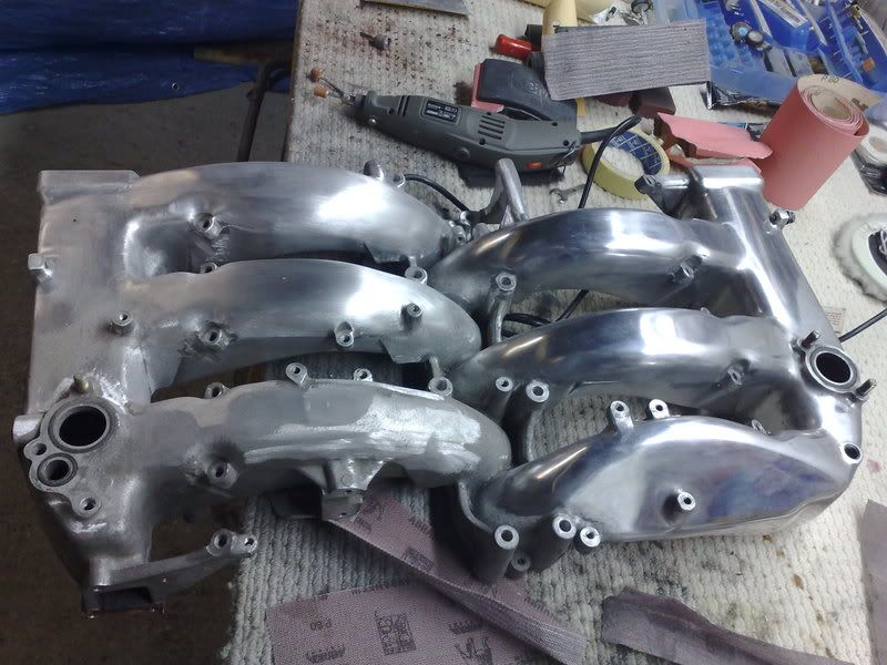

A dremel for all the tricky bits and various grades of sand paper.
I used 80,120.240,320,500,1200 to get it all smooth then i used a few different grit rubbing blocks which i cant remember the grades.
I then took it to a metal polishers to give it its last buff up.
it took me and a mate about 25/30hrs. But it was worth it as doing it by hand there is no ripples or grooves from the polish wheels.

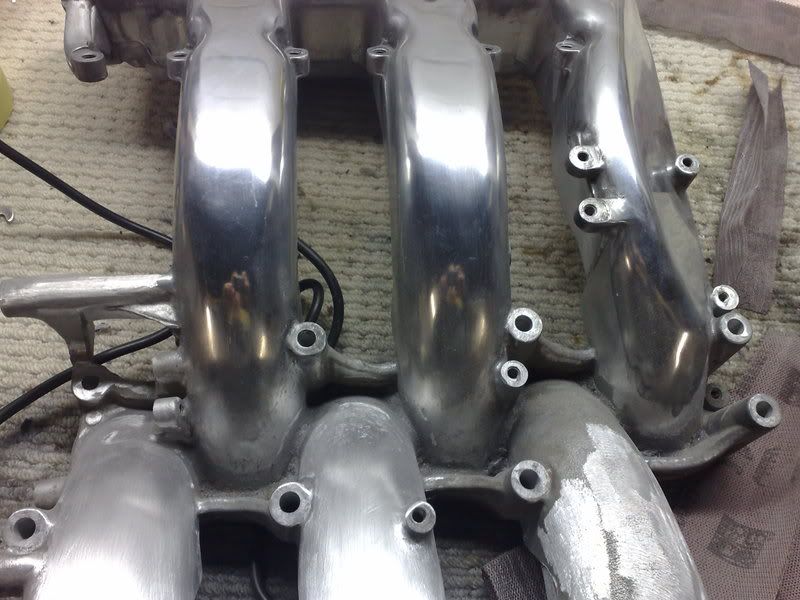

Not sure on the finish mate!
I got the rubbing blocks from a mate of mine,, it cost about £20 for the plenum, water pipes and throttle bodies.

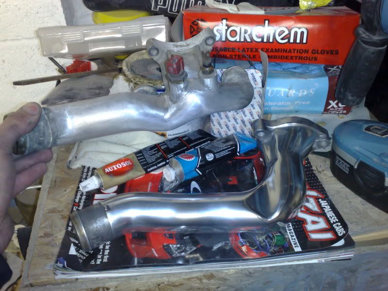

This was the kind of finish i was getting from using different grades of paper and rubbing blocks.
After polishing

Start off with the water pipes first they was alot easier to do.
Use a sanding block if poss on the flater areas this way you get alot flatter finish no ripples!
