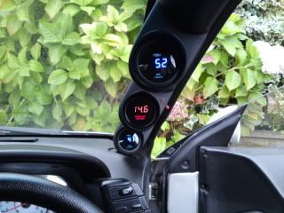

Meeee :D i got on wired up inside my car, i plumped in a pressure sender after the fuel filter then wired it threw the firewall to my 3 a pillar pod it works very well :D
Ive got a glowshift digi gauge which reads well had no probs yet :D

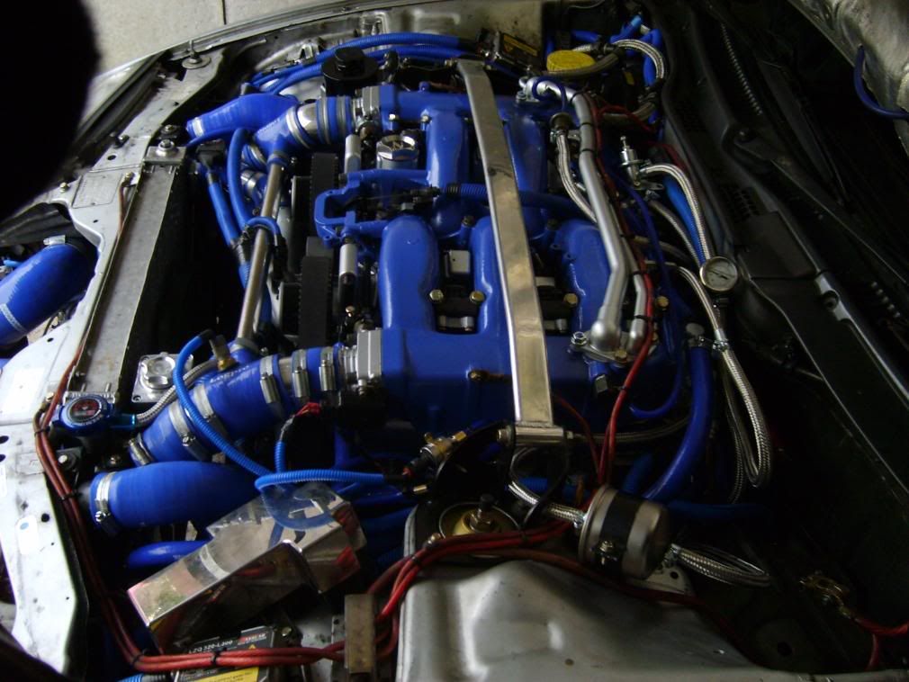

I got a pic somewhere hang on.
Its the gauge at the bottom reading 41 psi.
heres the sender, I needed to buy a fuel T piece and two red finishers from demon tweeks, i cut into the braided line then plumbed it in. I just ran the ground to a good earth and the other to the gauge. Easy.

Hi Jimmy thanks for the info so quickly, So couple more questions, Can i use any PSI gauge as long as the range is big enough? do i need a specific sender or does it comes with the gauge? im gonna have a gander at demon tweeks now i think.....
I bought the gauge from ebay but i needed a few bits from demon, The pressure senders for most aftermarket applications are within the same range, the only difference is the writing on the gauge i suppose unless there are different tolerances for fuel and oil?. For example you could just but an oil pressure gauge&sender its all relevant and reads the same but why not just buy a fuel pressure gauge & sender? seems like more work fitting bits here and there. Wont set you back much for a good working gauge from ebay anyway.
JFYI you have to get an electrical fuel press gauge, it is illegal to run a direct feed, if you have a crash it could pump fuel into the passenger cell!
Yeah defo use an electrical one :D buy the gauge, sender and sorted.
