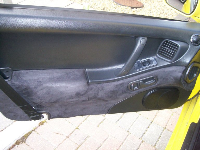

I've got some Alpine component speakers in the sloping part of the door card, just under the window, near where the door joins the dash housing. Greg did a great job of fitting them for me. Measure up, take the card off (mind you don't break the clips), use a hole saw on a drill, connect the wires, seat the tweeters, and Bob is your mother's brother.

I fitted mine in the top of the door above the air vent. The tweeters swivel as well so I can angle them towards me:)
thanks all, that looks like a winner. Did it involve cutting any steel or was there enough space behind?

No cutting thru' steel - it's just like a hardboard with a plastic covering.:duffer:
Great stuff. I just wondered if the speakers touched the actual steel of the door but if not then alls good.
