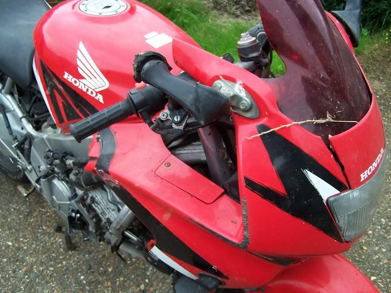

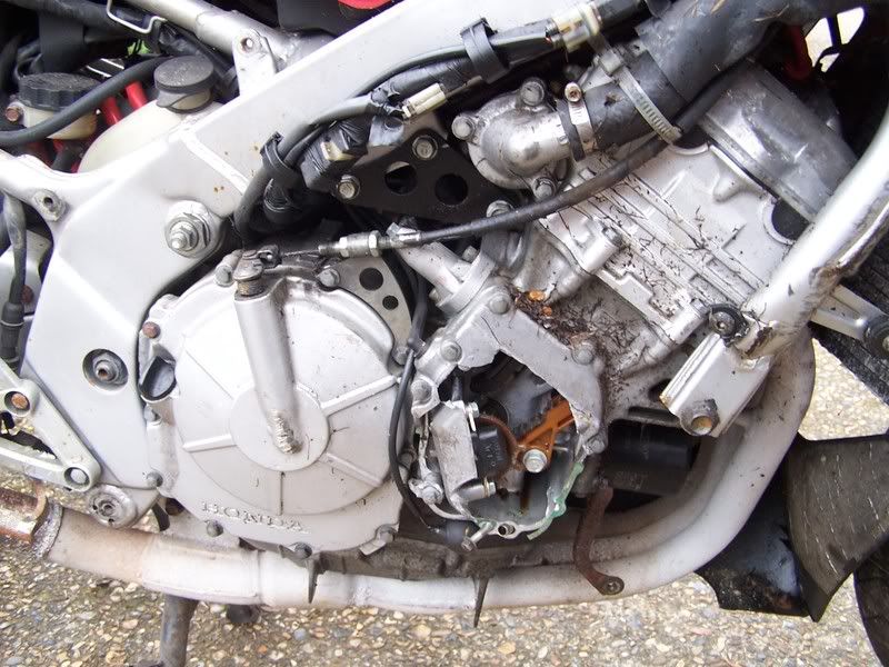

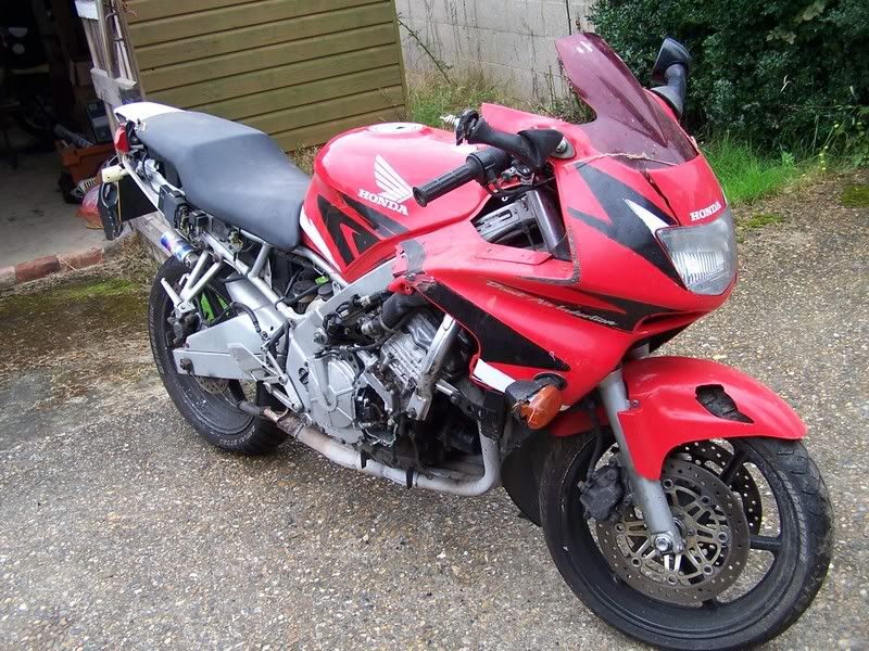

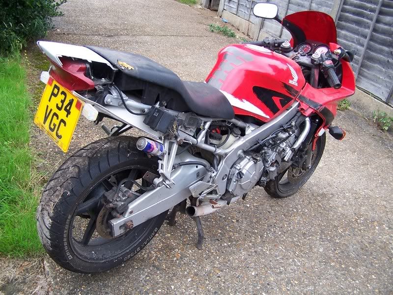

I had a bad off on this bike 5 years ago now. It went down the road and up a kirb. Apparently the engine was running and it got switched off but he timing case was broken. I want to see if the engine is dead or if i can get it running. Its been sat in my garage and hasn't moved for 5 years.

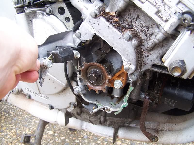

What is the sensor that is broken off? Does it send a spark to the plugs? In that case the engine may be ok? i.e the timing never went out and popped a valve into a piston. The other worry is that the engine was running without oil. However i can push the bike in gear so the engine isn't seezed.
So my questions are: Can you see anything that would have knackered the engine from the photo's and the amount of time it's been sitting? Should i just try and get an engine casing, fill it up with oil and try to start it?
The other broken bits are more salvage yard jobs that i can source but i don't know alot obout this engine . I'm now disabled so i'll need to adapt this bike to get it on the road anyway. Its going to be a good project to get into if the engines ok!

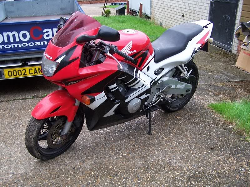

THE GOOD SIDE :D
The good side isn't far off mine, best colour scheme IMHO :) well other than the repsols.
Looks like some nasty damage, hope you didn't damage your self too much!
The cosmetics are easy done, not sure on the engine though :(
There are always lots of fairing parts for f3's on ebay for a few quid, mirrors, engine casings are all cheap, so fingers crossed nothing has got in there.

That looks like a sensor for the ignition timing, nothing to do with valves etc. anyway, as long as the crank has not been bent then the engine should be in good shape. So repair/replace that sensor and the timing case and it should be ok.

Plan is to order a haynes manual, take it apart a bit, flush it through, put a new engine case on, some thick oil in it and try and run it.
