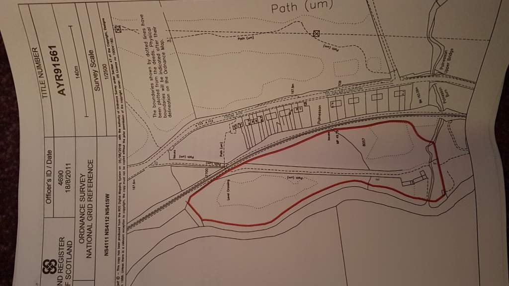

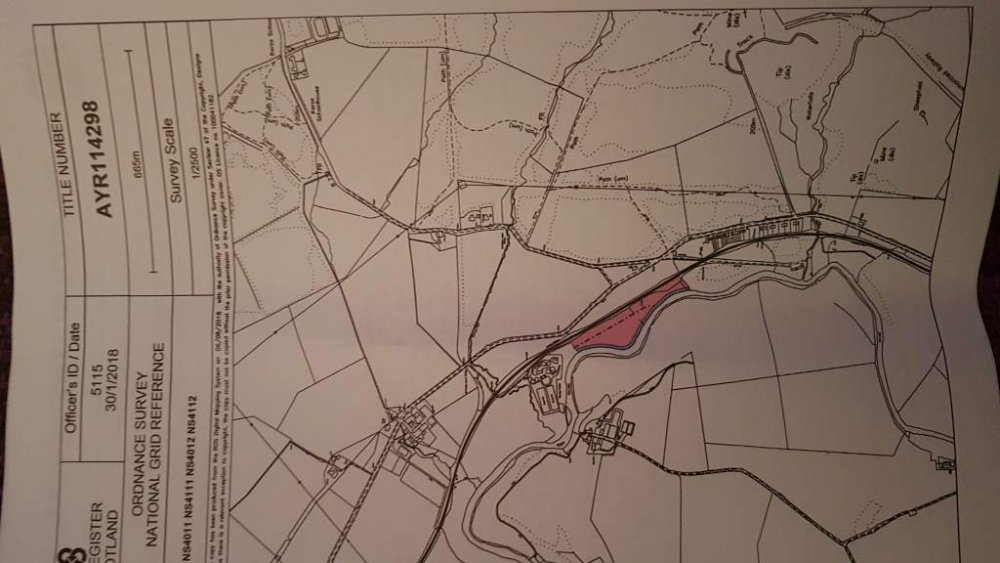

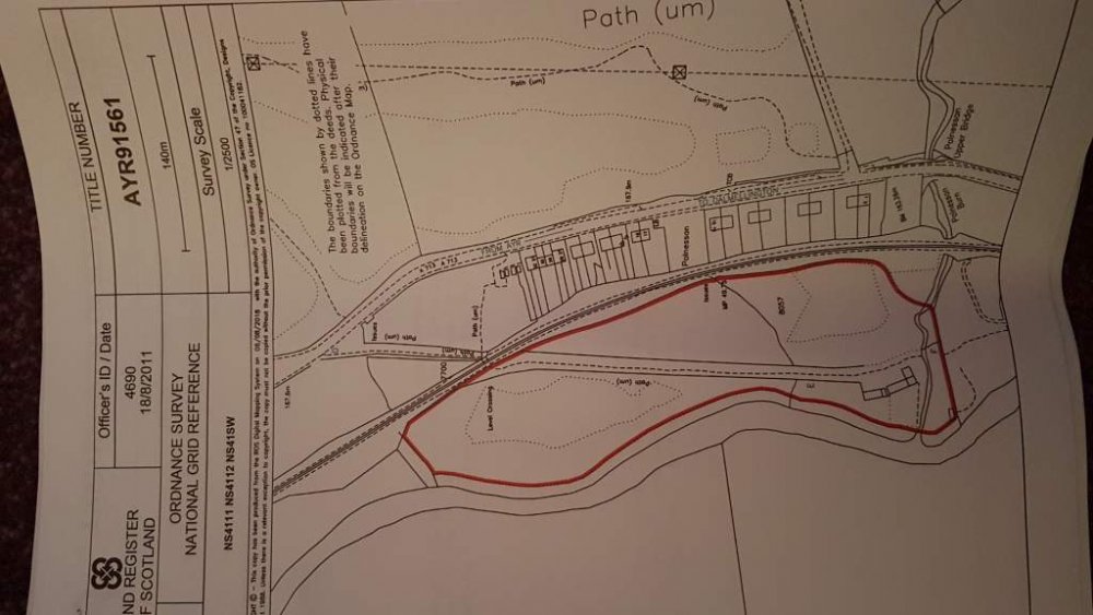

thanks for that mate, we are about 300mtrs as crow fly's to any amenities/services to plug n play. this site is going to be solely off grid, we are right by a river the Bonnie Doon in Ayrshire, and the covered track is about 600mtrs to the plot that goes over a railway line (disused) gonna be fun we do have another entrance to the site that is about 3/4 a mile opposite direction.
Edited by toolboxtrev
1st pick you can see remains of outline of building. 2nd pic is the alternative across the land to right of way to get on to land great fun.
