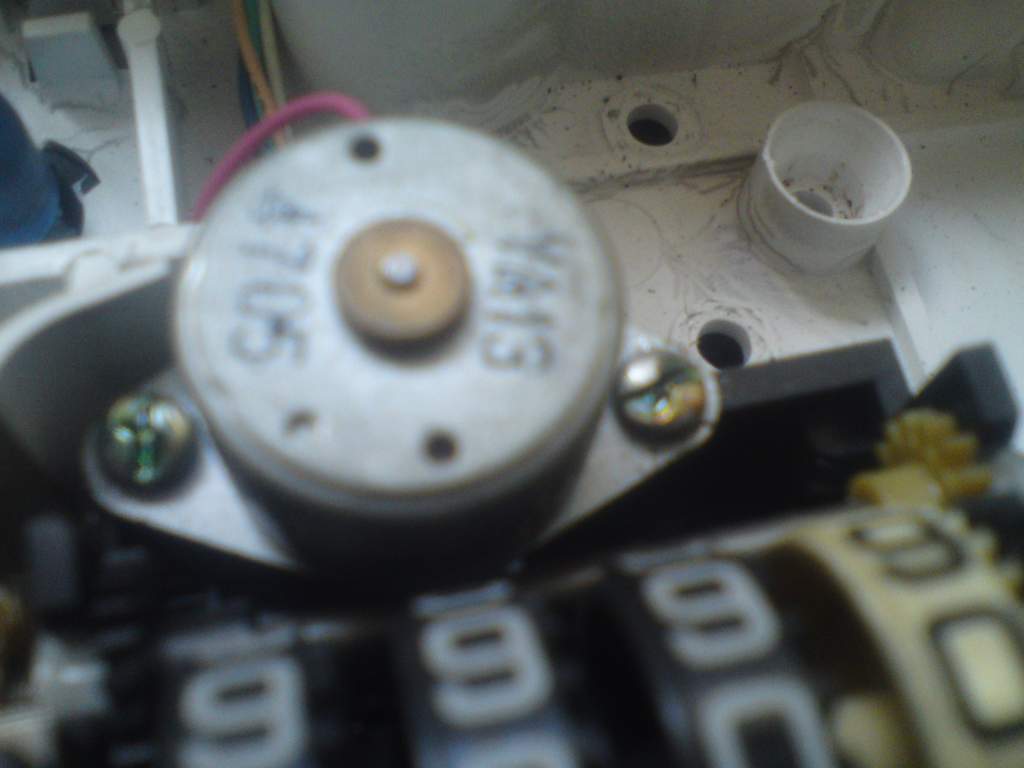

I've ask a few times before, but has anyone got a late style speedo, or just the odometer section, Mines never worked and given I've got to run a rebuilt engine in soon would like to know what my milage Is.

It's not been working for a while looking at its mot's.
Tried everything I can think of, think it's the stepper motor that's dead, but early ones are much bigger,
Can't even find anything universal I could put in there, maybe I'll piggyback an early one externally at least while I run the engine in,
I've had a look at my stock, it looks like i have 'your' old one because the tamper screws have been dremeled.
I am wondering if your problem is NOT the motor because it's had 2 fitted now as far as i am aware and both do not work, perhaps something on the flexible board, bad connection, etc, is the issue.
I do have a full working set of clocks that i could send you to test, if need be you could then 'pinch' the odometer assy out of it and migrate into yours.
I also have another assembly that i believe works also.

After further liaising with Ash, i am sending him an untouched odometer/trip with a 122km reading, i should of sent to you Wavey first for winding back for the correct miles reading !!
Is he volunteering? Lol, unfortunately it'd actually over 122k now, have lost its exact millage but at least I'll have a mileage for its rebuild engine.
