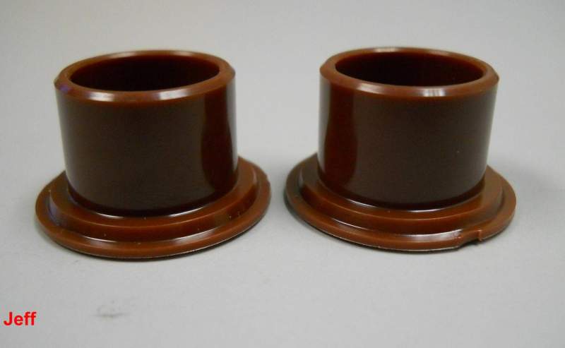

Gear linkage bush kit
Seem to be having a nightmare locating a kit.
Gear stick is all over the shop.
Want a new kit. Preferably UK based.
For the benefit of others what you need if your manual gearlever has too much play is the two brown shifter bearing as in the pic below, they are available from your local Nissan dealer parts no: 34139-30P00 or of course Mike here in traders.
Jeff
Also stocked by CZP, very cheap. I have a pair here in case I'll need them :thumbup1:
