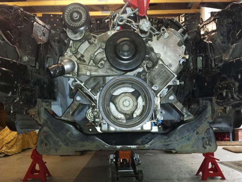

Well back in June, Ian pulled the power plant from that car as the car itself was starting to be pulled apart by the constant torque he was throwing through it.
This is what he removed:

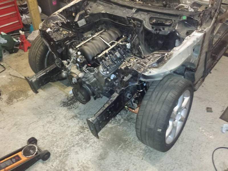

And this is what he decided to put it into:

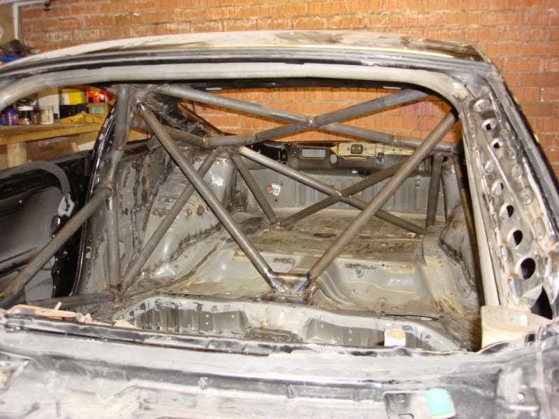

He has a custom cage installed by Clark Customs:

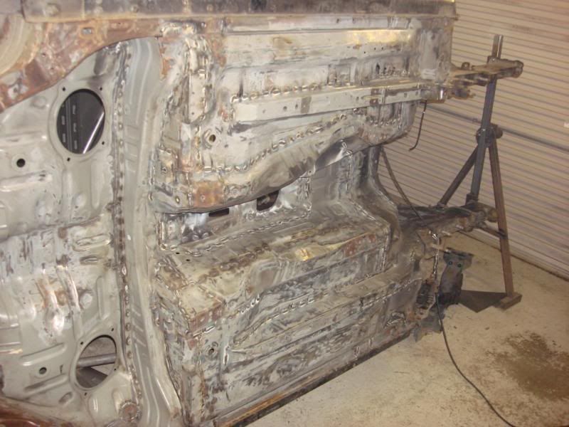

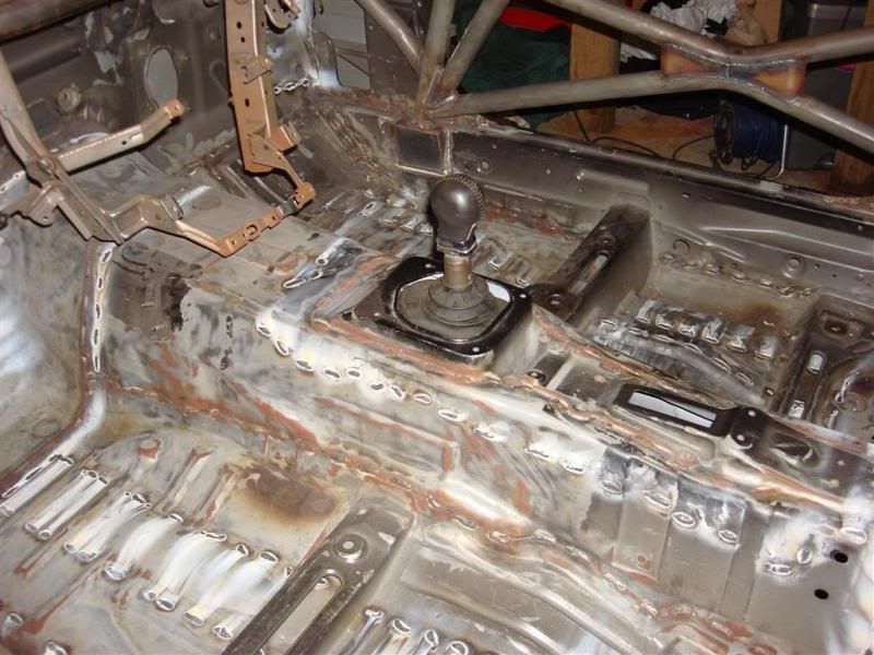

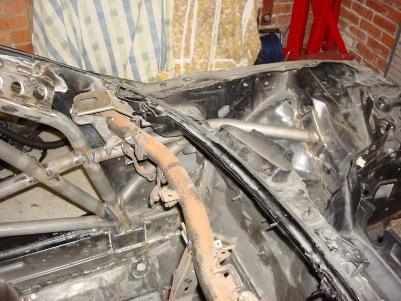

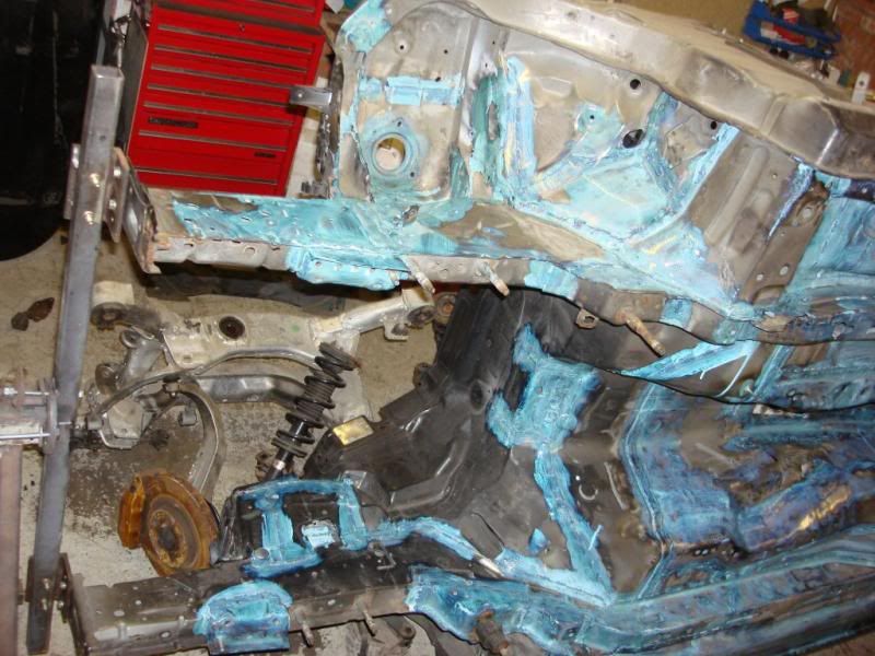

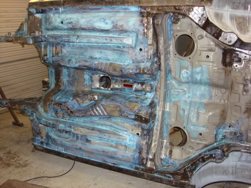

The interior is obviously fully stripped out, and he has fully seam welded .

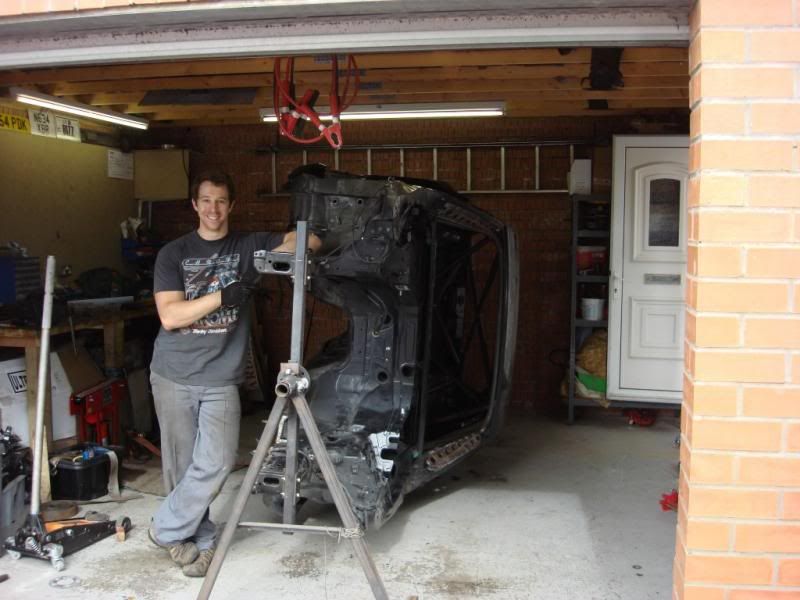

Car then rolled onto it's side:
And the seam welded restarted.

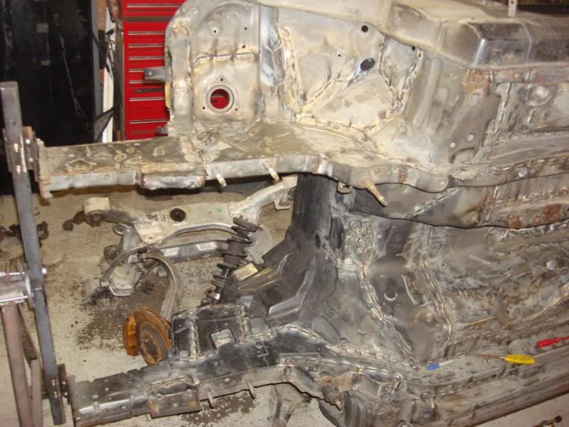

This is where he was as of last night:

Latest updates from Ian:
Ok.... so after another weeks worth of evenings here we are...
Here is the front end done that I did before tea tonight

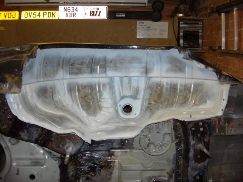

So now for the NeutraRust kindly donated by Lexx. Cheers bud. Anything that was weld or bare metal was covered ready for a quick layer of primer tomorrow
Love the colour before it dries
And more:
"SEAMWELDING IS COMPLETE!!!"

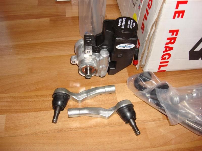

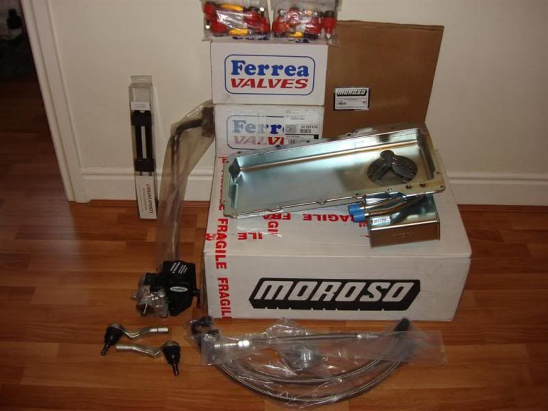

Father Christmas came early today and dropped a few bits off now that I'd finished the seam welding....
... See anything you like?? :D

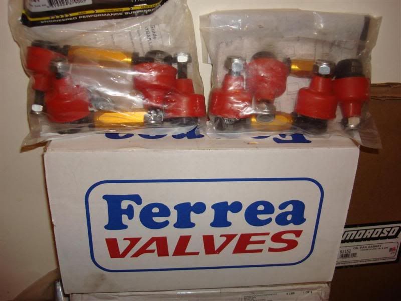

Heavy duty Turn-One powersteering pump to replace the pathetic original pump which cost me a season and some Tein track rod ends
Whiteline drop links front and rear on top of the new forged Ferrea intake and exhaust valves for the LS3 (new cam, springs and other head ancilliaries to arrive soon)

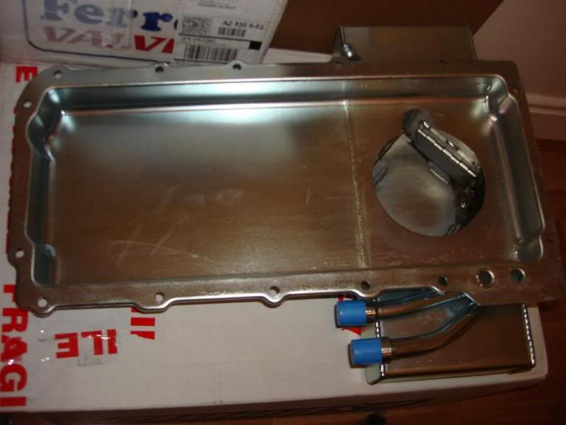

The new Moroso LS350Z oil pan :) You can see one of the four trap doors in the recess. Looks like a really nice bit of kit which came with the oil pickup tube, gasket, braided lines, filter relocation, oil fittings, dipstick and fixings. (I should hopefully be making my own version of this in near future so anyone wanting an LS conversion should be able to get everything from the UK)

I've been meaning to update this one for a while:
LS3 is now sitting on its own mounts
Yup...that's a 6.2l LS3 with a T56 attached now sat neatly in a 350z.
Gearbox sits perfectly meaning no adjustment to shifter or shell needed:

Very nice preparation work. Which NeutraRust product was used?
NeutraRust 661. From GCS.
It's the same stuff I use on the ships at work. I liberated a few litres for Ian to use.

One point though the LS has a lot of know oil supply issues when drifting that causes the bearings to run dry.
Most go dry sump, I take it this trapdoor sump improves things ?
