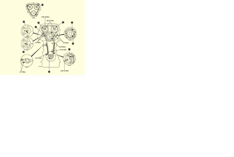

almera.jpgN15 model you either have a 1.4 or 1.6 according to autodata, no special tools required. You have 2 chains and need to align the copper links with the marks on the aux and cam sprockets.
I had a good read through the haynes and to be honest it looks a right pig of a job and as he needs it quickly (i'm very slow but thorough :)) He's going to get the garage to do it..
