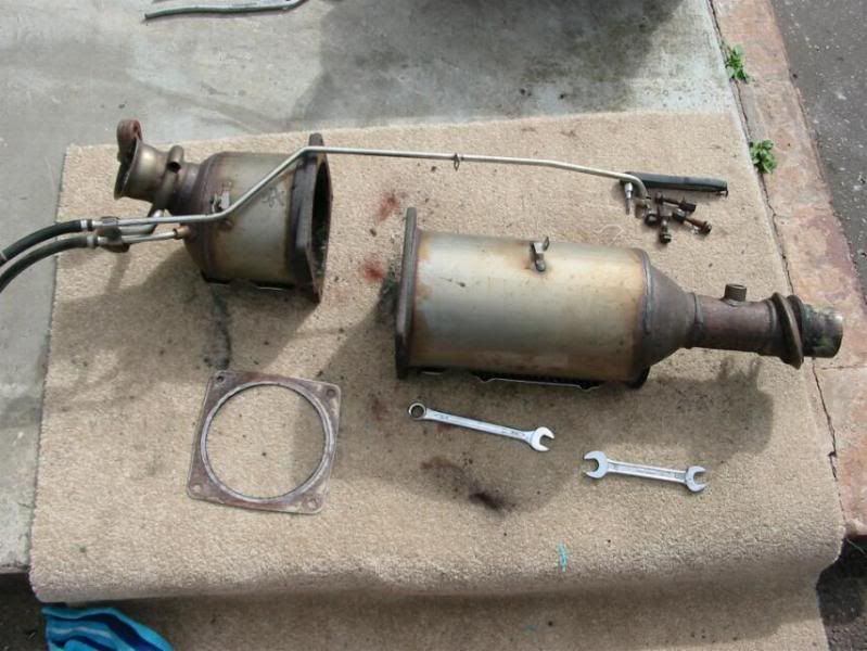

What appears to be blowing here?

We've just bought a Peugeot 307 HDI, there are some sooty deposits around the turbo but I'm not sure where it has come from, a message flashes up saying the depollution system is faulty and I'm not sure if this could be the cause?
Any ideas what it might be...? Any help would be appreciated, cheers mikey bean lol. :sweatdrop:
The error code most likely referes to the particulate filter (takes the soot out) there is a set proceedure for regenerating this, however if its not been done correctly it may need replacing or you could remove it and attempt a manual clean.
The soot in your pic could be caused by the extra back pressure and / or a faulty gasket.

Wow that is fantastic guys, thanks for the assistance! there are no symptoms when driving and it appears to run correctly, so may have to get cleaning things out to try and sort it out as I dont want it to go into limp-home mode.

Just had a thought, while the dpf goes through a regeneration it needs all heater plugs working correctly to help with the regen, so a faulty heater plug could stop it fully auto regenerating, check them first as it could be an easier and less costly fix.
You may also want to check your ELOYS tank which is the addative used as part of the regen cycle, this can be refilled but care is needed to fully bleed the air out or it will not work.
As Mikey said failure to deal with the problem will very likely cause turbo damage, once you have sorted the issue out make sure that at least once a month you take the car for a good exciting drive, its lumping around town that is causing early failure.

for 'regeneration' to occur you have to get a few parameters right. It'll want a high soaked temp in the exhaust/settled water temps/might want you at constant revs above idle- So motorways do have a use!!
Different regeneration from each manufacturer I'm suggest(On Nissan you force them & you could plug-in and read if the regeneration has or is occurring)
