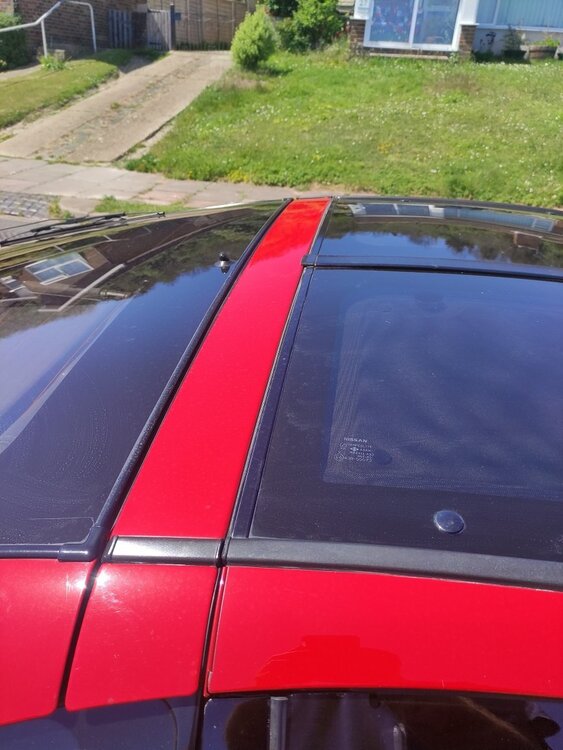

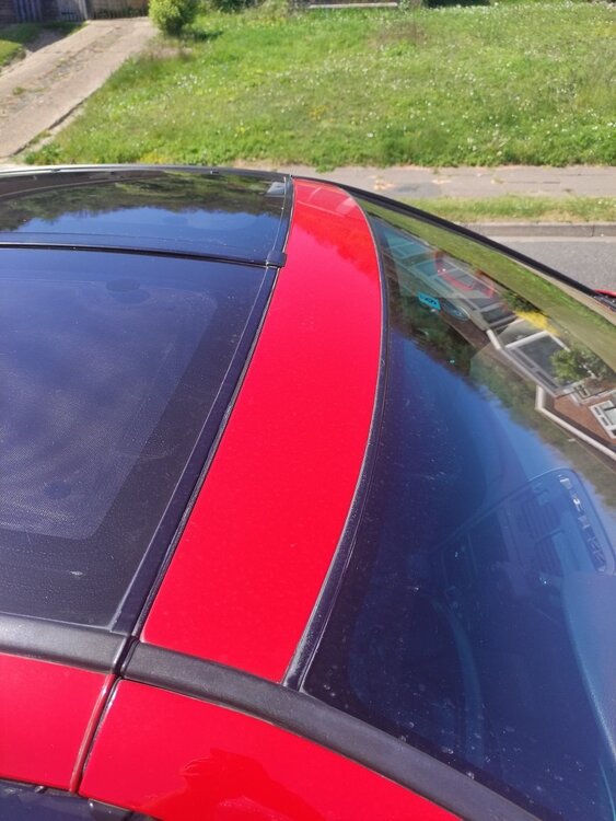

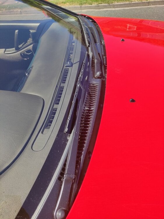

I did release it in February to have the scuttles, wiper arms and the roof beams painted.
The pictures don't do it justice as it was a bit dirty!

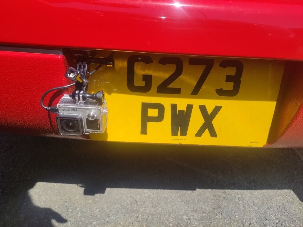

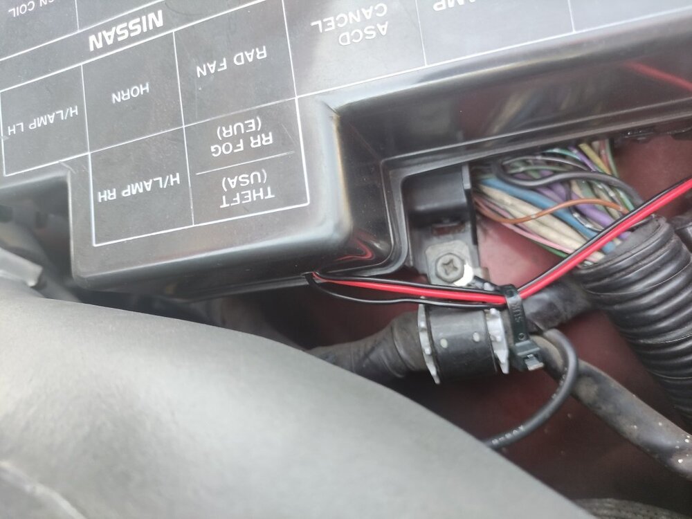

So after looking around the car I decided to connect the front one to the fuse box in the engine bay. This made it easier to hard wire it and meant I didn't have to faff around getting wires through the firewall. I used the hardwire kit in the fuse slot for the horn, so if it ever blew a fuse then only the horn would stop working and nothing important like engine/lights/AC would die! If the horn stopped working it would also warn me that the gopro wasn't charging anymore, so nice bit of system feedback there!
As you can see I had to drill a small hole in the fuse box lid as it was too tight a seal and was crushing the cable. The hole has been sealed with blacktack. The cabling runs down under the N/S headlight, nose panel and then behind the front bumper, its all cable tied in place with just enough slack to reach the GoPro. The camera is mounted upside down on the bumper behind the number plate. One of my requirements was that everything must be hidden as the GoPro mounts DO NOT come off....ever.... The camera gets some good "Gran Turismo" footage, as my friend likes to say. The red LED on the camera means its got power! Please ignore the mass death, the car will be getting a clean shortly!

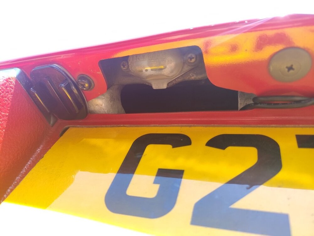

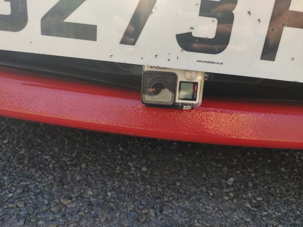

The rear camera was a bit more of a faff. As far as i'm aware there is no fuse box towards the rear of my car and as my other requirement was that all the wiring could be removed if I needed, (e.g no hacking into looms) then it had to be the fuse box next to the accelerator. My hard wire kit wasn't long enough, but luckily I have a roll of 14AWG (for my model railway) in the garage. I ran the cable from the fuse box, under the carpet by the door sill, then up the rear seat side trim and into the boot. The hard wire kit was attached and then threaded through the rubber grommet that takes the wires through the boot floor and down to the rear number plate lights. I then attached the hard wire kit at the other end to the fuse box and hey presto we had power!
As you can see from the pictures the cable is long enough to charge the camera, but tucks away nicely when not in use. The camera is off to the side so not to block the number plate as that would be bad! The mount will never come off, but if I do need to chisel it off, at least it's on a part of the bumper that won't be seen and if it does need a respray it's cheaper to spray a bumper rather than a car! Again the red LED means the camera has power!

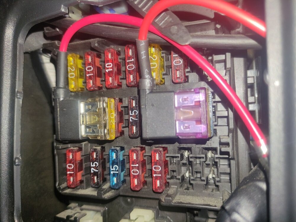

Here is a picture of the fuse box:
My fuse box diagram is in Japanese, so I've had to google where I want them plugged in. The left one is the dashcam, that's plugged into the rear window heater, if it blows a fuse, not the end of the world. It's been wired in since last summer and never had a problem. It has a continuous feed even when the key is out so that I can leave the dashcam running in a car park for example, however I do have to remember to disconnect the cable from the dashcam when I park the car up in the garage for weeks/months otherwise I have a flat battery. The right hand one is the rear GoPro hardwire kit, that's plugged into the front wipers. Now this isn't ideal, but due to the 90 degree and thickness of the fuse adaptor it doesn't always fit where you want it to go. My reasoning is that I mainly drive the car in the summer, so rain is less probable, the odds of blowing a fuse is low and if I do and the wipers stop, then I will pull the hard wire kit out and put in a spare 20Amp fuse that is on the fuse box flap. Also if the wipers do stop working at least I know the camera has stopped charging! I looked into the power draw of the cameras, the Hero 4 (I have 4x hero 4 silver and 1x hero 4 black) is 2.8w when recording or 3.8 when recording with wifi turned on. The dashcam is between 2-3w depending on the information source. All three kits use a 3amp fuse. nothing there should overload anything.

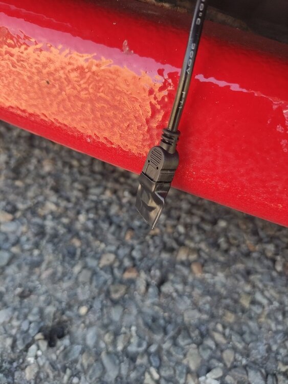

Lastly to protect the USB cables, I put some insulation tape on the end to protect them from grim and rain. The front one gets tucked away behind the bumper out of sight and at 14 cm long it's nowhere near the spinning fan....yes I checked that too!!!
