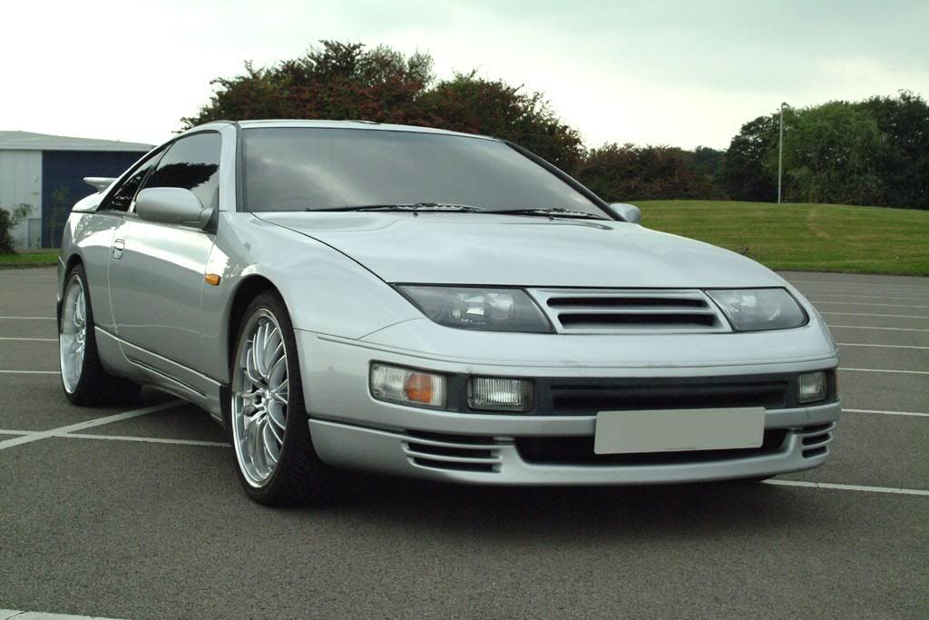

rather fine lookin zed you have there yewcheck, whereabouts in bristol u from?
Well thank you.........Staple Hill bud, not to far away;)

loving the number plate, and whats with the 80's boyband star in the sig pic??
