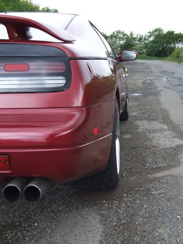

I think it looks great and is only noticable to the trained eye. But doesn't stick out.

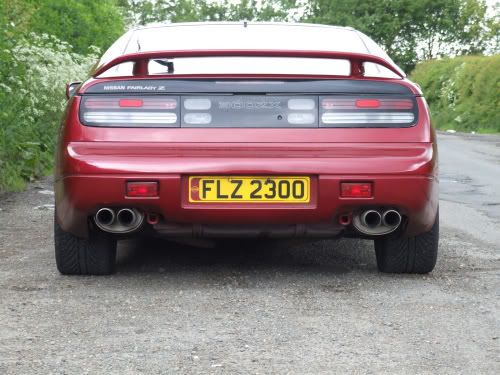

Someones stalking me :D :rofl:
The only reason that I don't have the black pin stripe, is that I haven't got any at the moment, but it will be going back on :D
BTW- The second pic down was taken just after I'd brought it home from the bodyshop, and typically, it stated to rain! :headvswal

I like it smooth think it looks good, how did you smooth it?, i got the same colour Z and im in the process of smoothing the pinstripe recess Iv'e already done the front bumper and it look great.
Actually i had noticed this on my balck zed as well. Daves looks really sweet, how is the paint standing up to the test of driving though as i thought it was different paint to be more resistant to stone chips..?
Well on the bumpers, it's moulder into the plastic. It's barely a few thousand microns deep, so sanding it will not effect the rigidity of the bumper at all. The sills, mine were already done by the last owner. Seems fine. Dave's also got the Z mud flaps. I thought about getting those, but leaving them off for now.
Since mine never gets driven in the winter where the grit and crap is present, the finish should last. Not all cars have stone chips stuff on there. You can get impact paint I think which you can add to normal paint which enables to the paint to 'give' a little bit. Bit like plastesiser.

When I re-sprayed my car I had to sand it smooth because the flakes made it bumpy, it’s smoother than it normally would be which match’s the 99 spec front bumper. I also had to find a sign maker to cut me some black matt vinyl strips because nobody makes coach lines anymore.

Do you have any close ups of your rear bumper by any chance?
What pin-stripe? :confused:
The little black line where the swage line is.
There's no black lines on mine.
